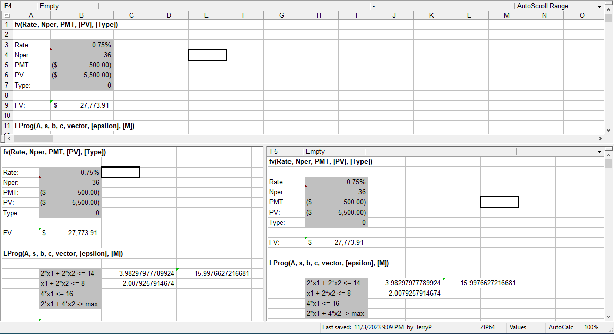

If you want to maximize the worksheet display area to show as many cells as possible — especially after splitting the main view — you can hide all interface elements except the cells themselves.
2. Steps
- Hide the table toolbar using the toolbar button or the View > Table Toolbar command.
- Open View > Headings & Scrollbars and deselect:
- Column Headings
- Row Headings
- Horizontal Scrollbar
- Vertical Scrollbar
Each view can be configured independently. The final result may look like the following:
